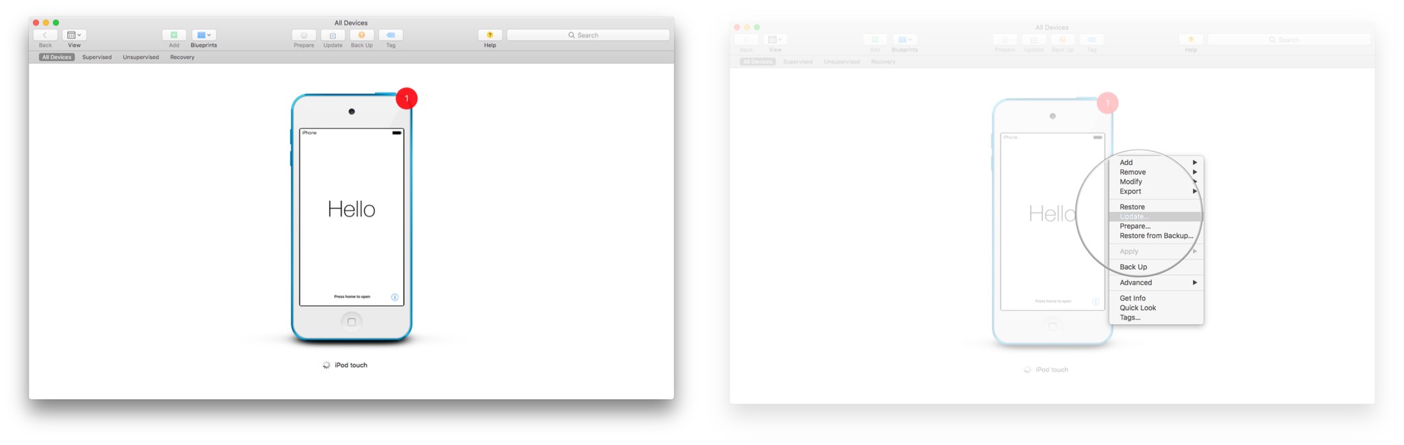

- Option click the image of the device you want to update. If an update exists, a little red indicator will be present above and to the right of your iOS device to reflect that.

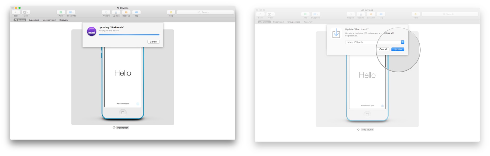

- Select Update.
- The update process will ask you if you wish to update to the latest OS. If you have various revisions of updates downloaded, you'll be able to pick which iOS version you want to update to. Once selected, click Update.

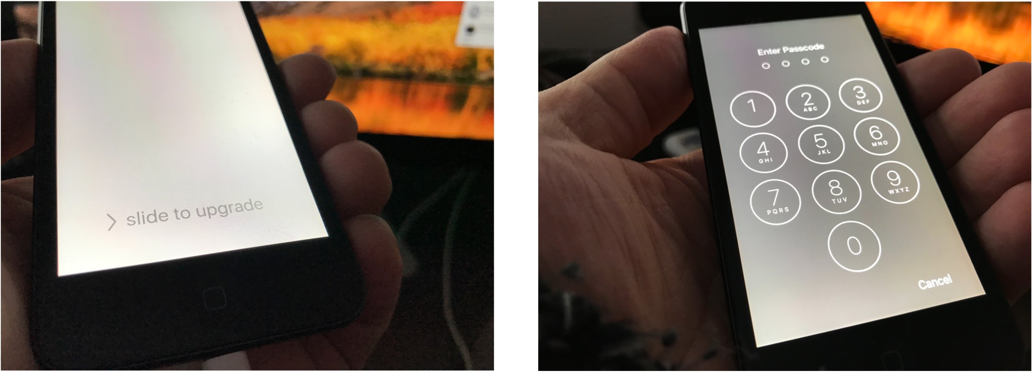

- Slide to unlock your iOS device.
- Enter your passcode.

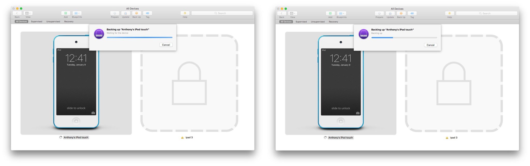

- Option click the image of the device you want to back up.
- Select Back Up.
- Wait for the back up to complete. The back up process will now save a local back up file for your device. If you have an error saying that the device is locked for the back up to continue, you'll have to slide to unlock and enter your passcode on the device to complete the installation.
