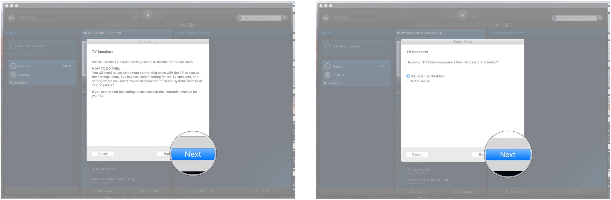

- Click Next once you have disabled your TV's speakers and set your TV's audio output to external speakers. This can be done using your TV remote in the audio settings in your menu. This will vary by television.
- Click Successfully Disabled once you have set your TV's audio output to external speakers.
- Click Next.
- Click Next on the TV Speakers screen.
