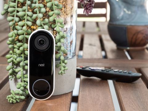

Nest Hello basics
Here's the gist: Nest Hello is a $229 video doorbell that's powered by a low-voltage wiring system. There's a good chance that if you already have a doorbell, you've already got this. But ... it needs a low-voltage system with a transformer capable of handling 16V-24V.
As the name implies, it's got a camera built in. Plus a mic and speaker. So using the Nest Android or iOS app (or Nest's web portal in a browser) you can see who's at the door either live, or via a recording. You can talk to them, they can talk to you.
Your doorbell can still ring like it always has, but Nest has some excellent smart notifications rigged up. More on those in a bit.
