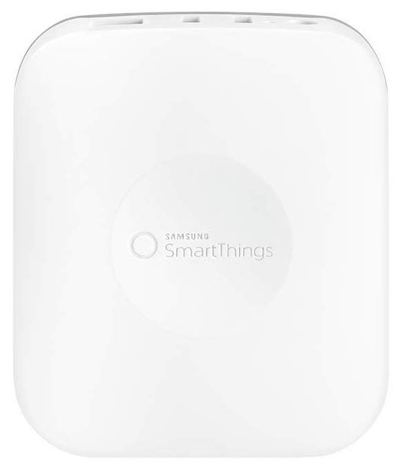

While SmartThings is a great way to control your lights, it actually doesn't connect to the Dimmer Switch itself without quite a bit of hacking and coding which neither myself nor the manufacturers recommend. Essentially, if you want to use a Dimmer Switch to control your Hue lights while they're connected to your SmartThings Hub, you'll need a Hue Bridge. The Dimmer Switch will connect to your lights via the Hue Bridge allowing you to control your lights with the remote. You'll need to use the Hue App to set it up but that's it.
To be clear, the Dimmer Switch will not connect directly to the SmartThings Hub so it will never even know that it's there, but it will also not interfere with anything. The Dimmer Switch will not interrupt your Hue lights connection to SmartThings and vice versa. SmartThings will still give you full compatibility with your smartphone or tablet.
