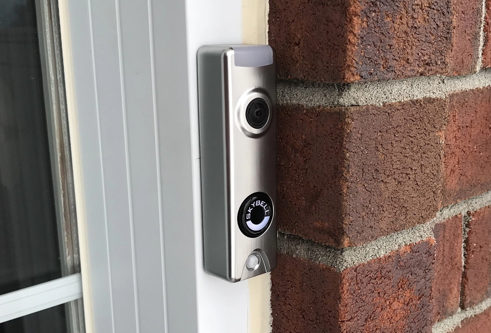

For our doorbell, we chose the Skybell Trim Plus for $200 USD. We needed a slim profile doorbell to fit on our door frame and it also supports HomeKit. A competitive replacement is the Ring doorbell.

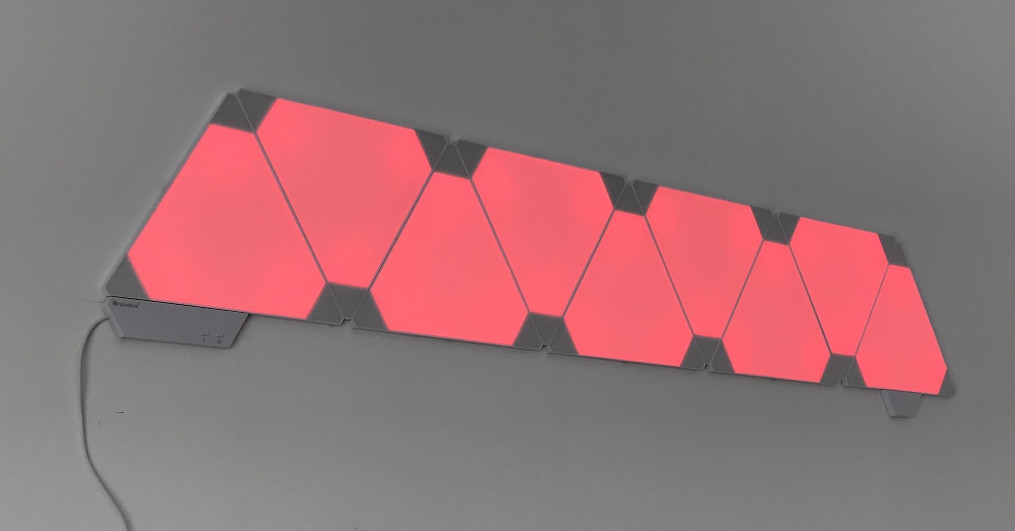

For our lights we chose the the Nanoleaf Rhythm Smarter Kit for $230 USD. These panels are highly customizable and you can make your own panel design. You can also add to your current panel if you ever feel like you need more lighting or a more intricate design. A competitive replacement are the Philips Hue smart lights.

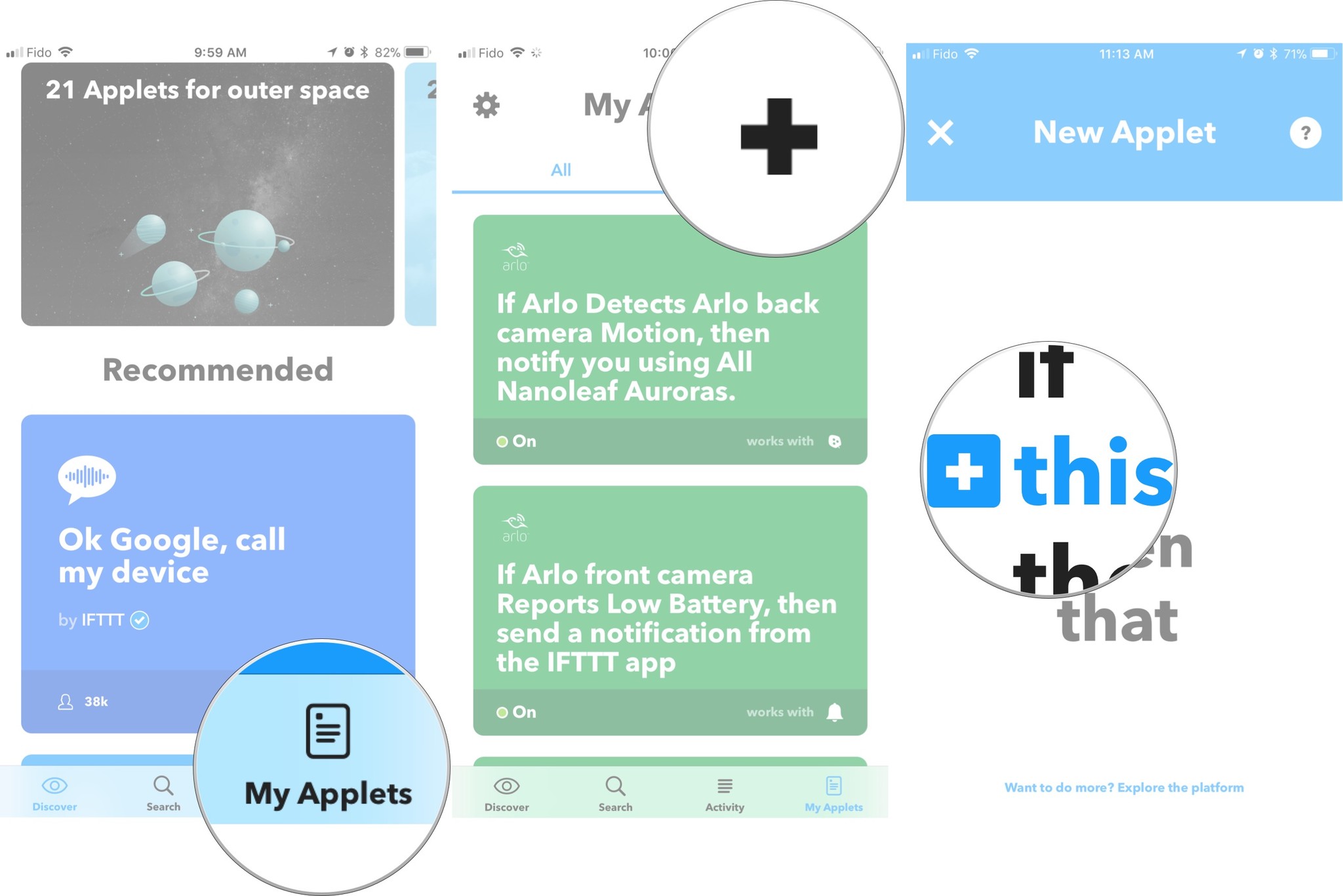

- Tap on My Applets.
- Tap the "+".
- Tap + this.

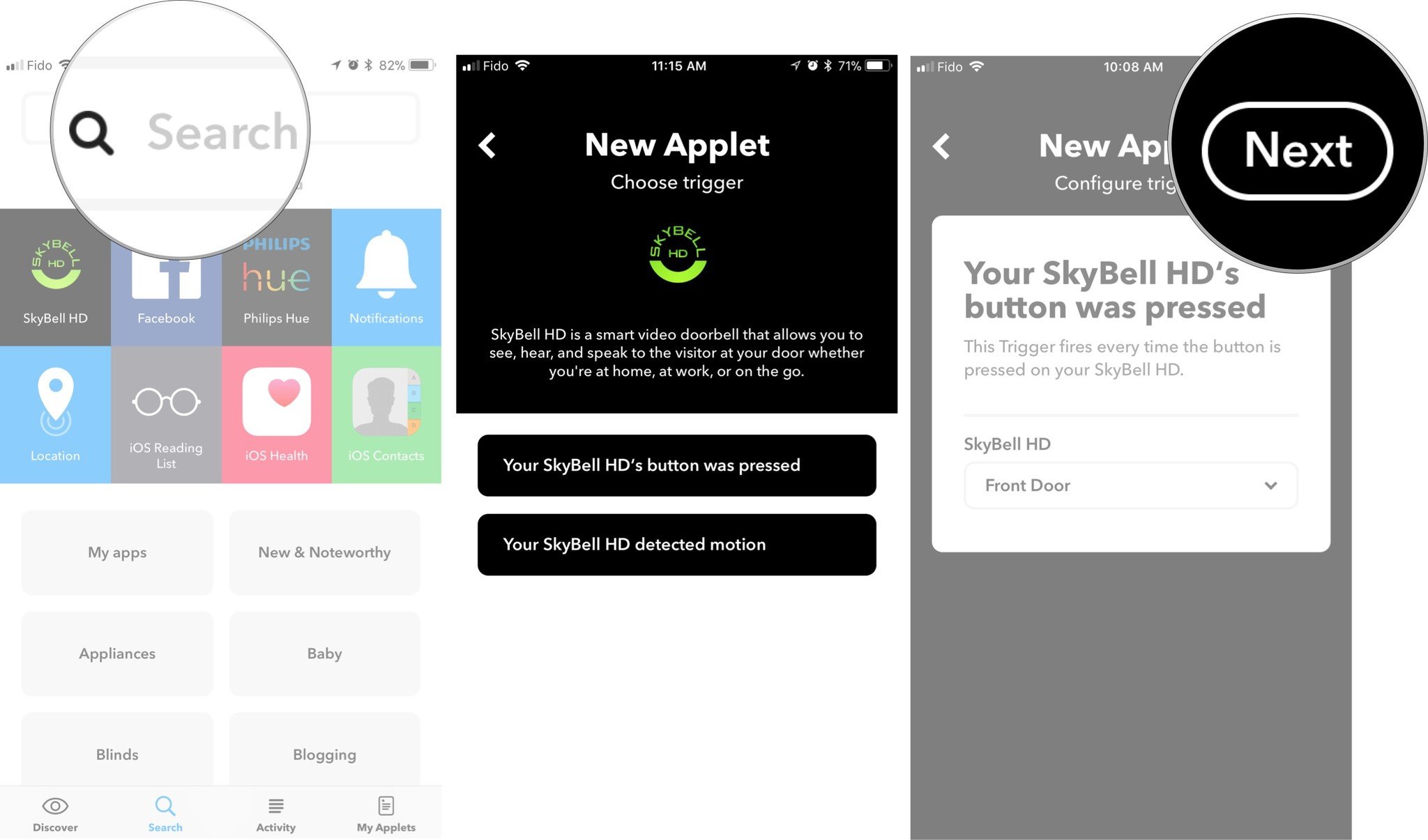

- Search for your doorbell manufacturer. In our case Skybell.
- Select Your Skybell HD's button was pressed.
- Select the name of your doorbell.
- Tap Next.

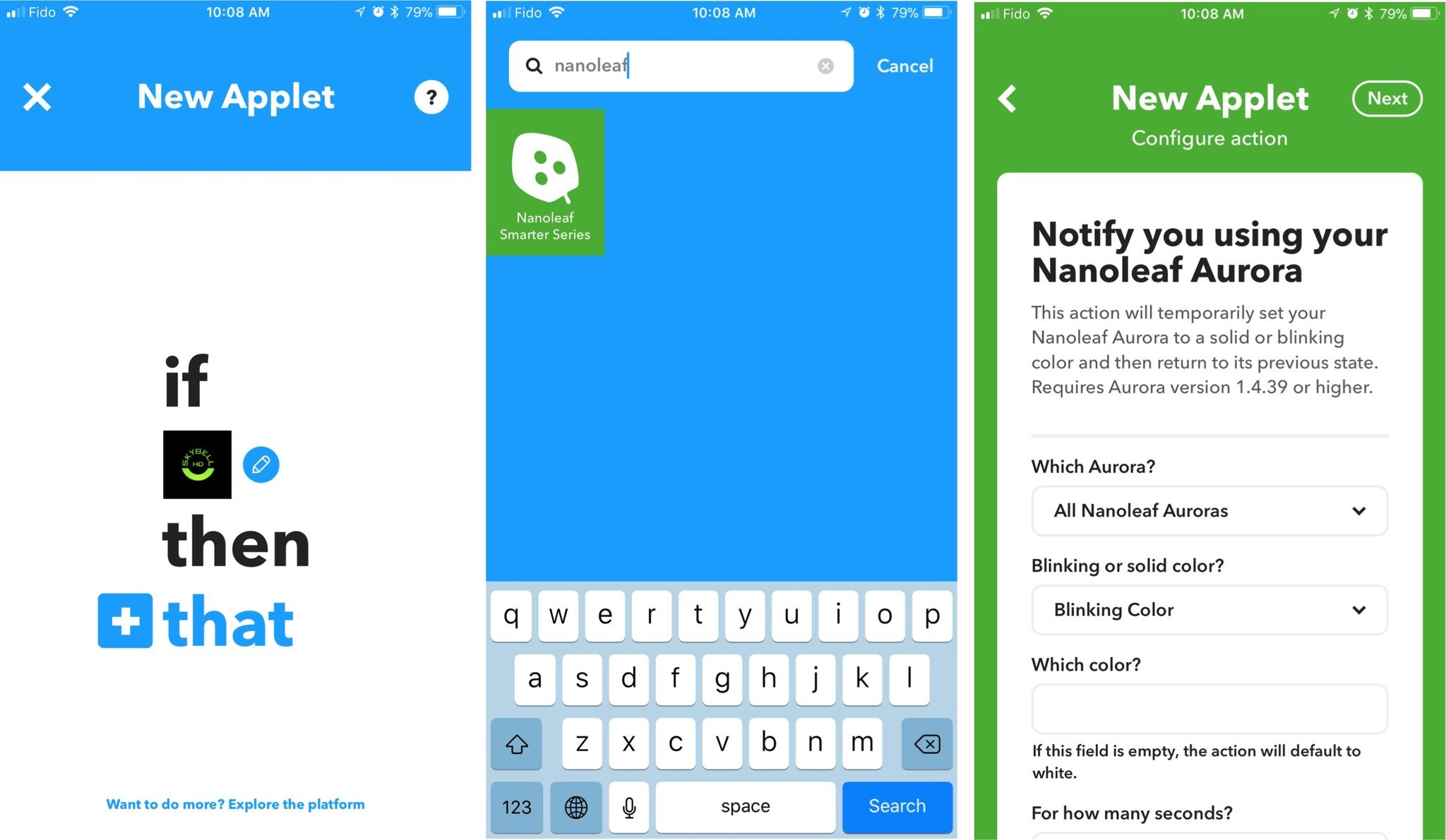

- Tap + that.
- Search for your light manufacturer. Here we type Nanoleaf.
- Select Notify you using your Nanoleaf Aurora.
- Choose Which Aurora you want to be used.
- Decide if you want a Blinking or solid color.
- Type in the color you want the lights to use when being notified.
- Choose how many seconds the lights will notify you for.
- Tap Next.
- Tap Finish.
