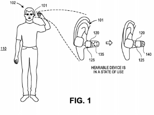

A newly published Apple patent has revealed how future AirPods may use an air pressure sensor to indicate whether or not they are being used.
As reported by AppleInsider, the patent is titled 'Acoustic in ear detection for a hearable device' and the abstract states:
A method for determining a current usage state of an earphone that includes a speaker and an air pressure sensor. The method obtains a pressure signal from the air pressure sensor that indicates air pressure proximate to the earphone, the air pressure sensor produces the pressure signal in response to the earphone being inserted into an ear of a user. The method processes the obtained pressure signal to determine that the earphone is in a state of use, and in response, performs at least one of (1) outputting an audio signal through the speaker signifying that the earphone is in use (2) establishing a wireless connection with a media playback device to exchange data between the earphone and the media playback device, or combination thereof.
The patent is based around improving the current tech within AirPods, which can detect when you insert or remove, the device from your ears. The patent notes how in many current devices (including AirPods), that this is currently done by proximity sensors. The patent states that this tech has its drawbacks, because it is susceptible to false positives, often activating in your pocket. The other option, measuring low-frequency sound produced when your earphones are inserted into your ear, requires a perfect seal. Anything less can again result in "inconclusive results."
The patent explores a technology that would allow the use of an air pressure sensor to determine the current usage state of the earphone. Simply put, the sensor would detect the change in air pressure induced by inserting AirPods into your ear, activating the earphone. Air pressure sensor technology would be advantageous over current solutions because it wouldn't require a perfect seal around the tip of your AirPods.
