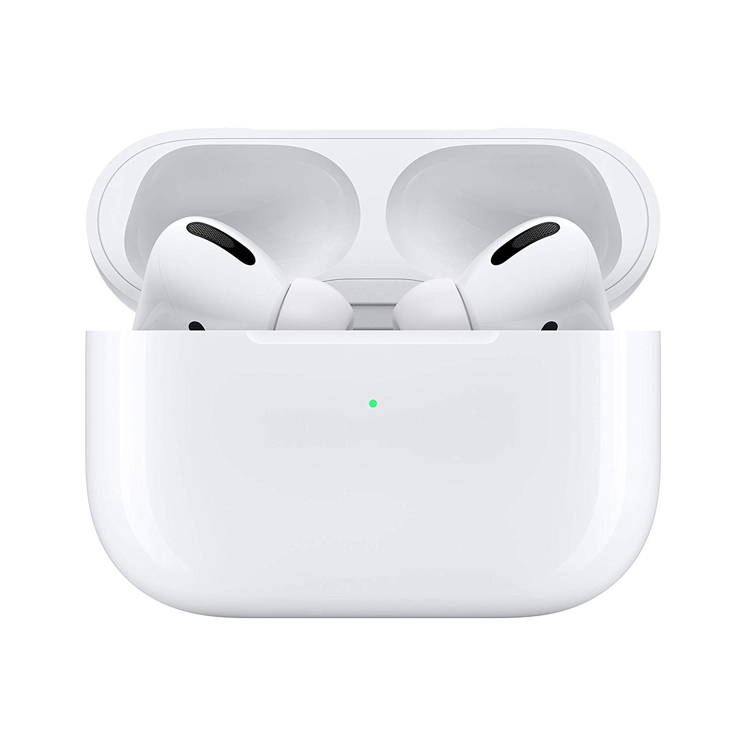

I pulled the battery case out of the box, lifted the cardboard separator, and saw the additional ear tips and USB cable were right where they were supposed to be. Lifting the lid on the battery case revealed the power LED to confirm the headphones had a charge, and instantly the start-up dialog popped up on my phone to connect these Airpods. I lifted an Airpod out of the case, and it looked exactly like a set of Apple Airpods Pro. The case was clean, and all of the pieces were intact. Satisfied that these were legit, I handed money off and went back to my car.
These were counterfeit Airpods Pro, and there was nothing I could do about it.
As soon as I started the engine, I finished pairing these earbuds to my phone and started listening to music. The audio quality was exactly what I remembered, not amazing, but a reasonable amount of bass and decent clarity. I reached up to my left ear, squeezed the shaft of the AirPod Pro to pause the podcast I had switched to, and noticed I hadn't heard the telltale click AirPods make when you activate one of these buttons. The podcast still paused, but the sound was missing. I tried again and the same result. It occurred to me maybe there was a setting I was missing.
I didn't find the setting I was looking for, but I did find the active noise cancellation and transparency modes. Only, when I tried to activate them, nothing happened. It didn't matter if I was in the Bluetooth settings or long-pressing the earbuds, the noise cancellation features weren't working at all. The UI would switch the icons, but no sound change.
Source: Russell Holly / iMoreFake Airpods (Left) and Real Airpods (Right) have very different labels on the earpiece.
Still not totally convinced this wasn't some software problem, having remembered early press review models of AirPods Pro had some intermittent issues similar to this, I looked up how to update the firmware on the headphones. That's when the illusion was shattered because while the Bluetooth menu seemed convinced these were real Airpods, the firmware update page for the AirPods didn't exist in the Settings menu at all. And when that happened, I started looking at the fine print. The serial number on the box didn't match the serial number on the AirPods Pro, the font and kerning of the tiny print weren't quite right, and the battery case reported a much smaller battery than Airpods Pro are supposed to have.
