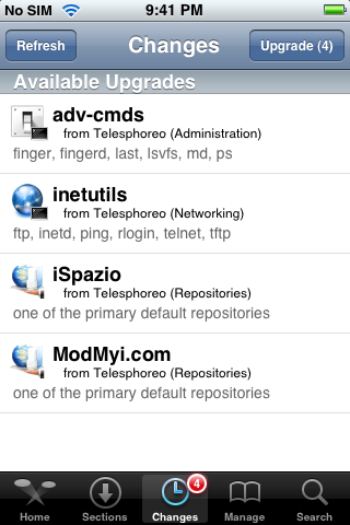

When the app is finally done with its first-run update stuff, you're going to want to hit the "Changes" tab at the bottom:
Go ahead and hit the "Upgrade" button in the upper-right of your screen to install everything there. The reason you're doing this is because PdaNet is hosted by ModMyi.com and you won't be able to download it until that repository is updated. The short version: go ahead and do those updates. :)
