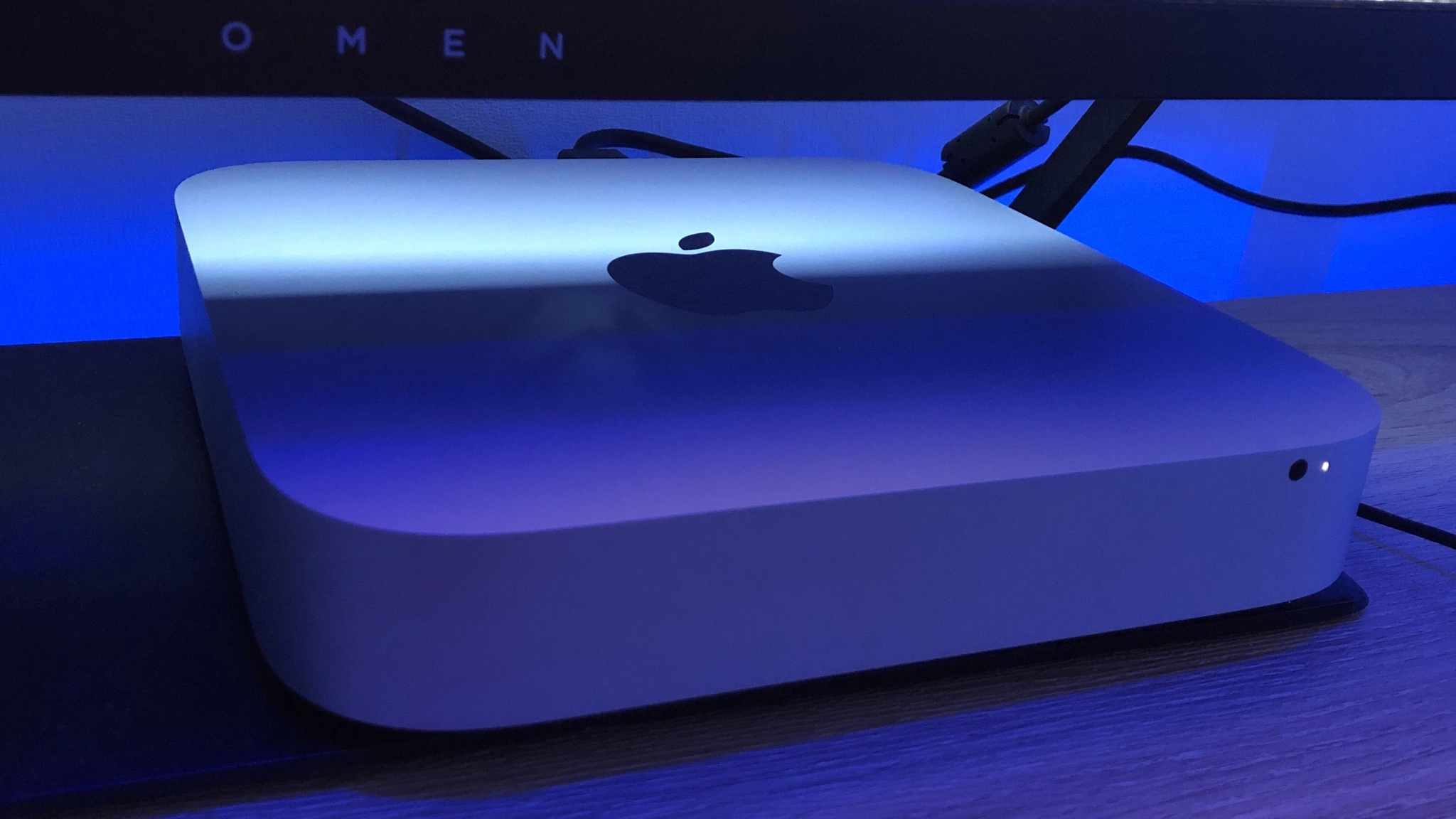

What you'll be upgrading
The 2012 model remains to this day Apple's last, properly upgradeable Mac Mini. On more recent models, users have been able to upgrade some bits, such as the RAM in the 2018 release, but in the 2012 model, you can go ahead and get really crazy.
You can upgrade the RAM to a maximum of 16GB; you can swap out the internal hard drive for an SSD, and even add a second drive for even more storage.
None of these parts are particularly expensive, and none of the work is particularly complicated or time-consuming. Set aside a couple of hours, and you'll be able to bring your old Mac back to life.

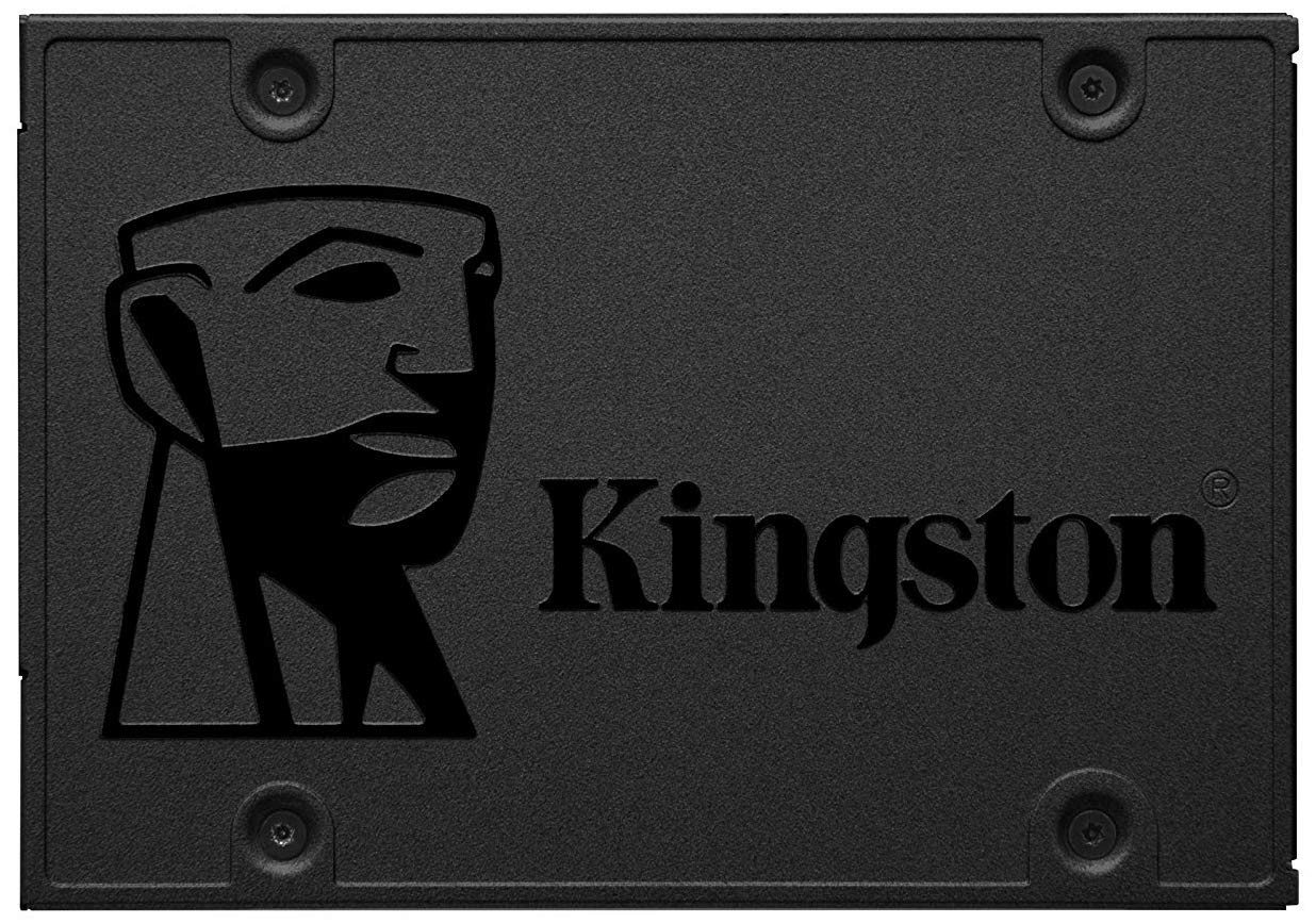

How to install a new SSD
Easy way to speed up your old Mac
Faster storage is one of the easiest ways to speed up your old Mac, and this 480GB drive will do just that for an excellent price.

One of the best upgrades to make is to swap out the old mechanical hard drive for an SSD. Data transfer speeds will be at least four times faster, and that will make a huge difference in the day-to-day running of your Mac Mini.
It's also very simple to accomplish.
