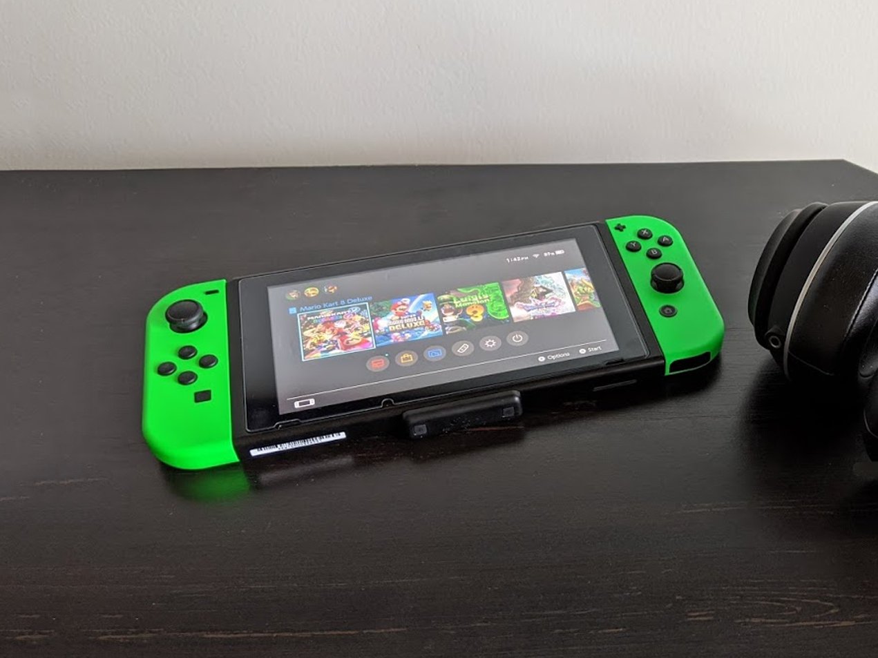

This method is no longer the only option. However, if you're having trouble pairing your headphones the other way it's a good method to try. You'll need an adapter with a male USB-C. The one we used for this guide is the GuliKit Route Air Bluetooth Adapter, which included a USB-C to USB adapter for docked mode.
Pairing in handheld mode
- Plug the GuliKit Route Air Bluetooth Adapter into the USB-C port found on the bottom of the Nintendo Switch.
- Turn your Switch on. The GuliKit won't work if the Switch is off or in standby mode.Source: Rebecca Spear / iMore
- Hold down either the GuliKit's A or B button for three seconds until the white light blinks quickly beneath it.
- Follow the individual instructions for your Bluetooth headphones to set them to the pairing status.Source: Rebecca Spear / iMore
- Place the headphones and GuliKit near each other until paired.
- You'll know pairing was successful when the GuliKit's white light becomes constant.Source: Rebecca Spear / iMore
Now you're all ready to play your Nintendo Switch in handheld mode without worrying about any cables.
