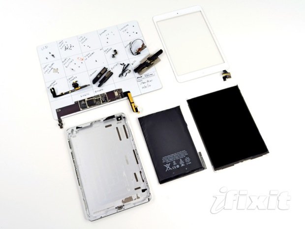

The iPad mini is no exception when it comes to getting torn down just to see how repairable it is compared to its larger siblings. iFixIt managed to get their hands on a unit a little earlier than the rest of us and took to tearing it down. It should come as no surprise that it didn't fare much better than other iPads and only earned a 2 out of 10 repairability score.
Much like its previous predecessors, the iPad mini's screen is held in with nothing but adhesive. While many of us may have been holding our breath and hoping that it would follow suit with the iPhone 5 display, it sadly does not. You'll still need a heat gun and some serious prying time to get the display off.
Once you've gotten the display freed, not only will you face even more adhesive, but super tiny screws that appear to be hidden pretty well. You'll need to make sure you remove all of them before pulling up any components.
We had to do some sleuthing to find some of the screws on this thing--several tiny screws were hidden underneath covers and inside crevices. Apple wasn't joking about "mini"; this iPad contains some of the smallest screws we have ever seen!
After locating all the screws, iFixIt realized that mostly everything else was glued in.
The screen is glued to the case. The battery is glued down. The logic board is really glued down. The headphone jack is glued in. The only good news is that the LCD is not fused to the front glass.
When it comes to DIY repair, this probably doesn't mean much that we already didn't expect. A screen replacement will be possible for most experienced DIY'ers and repair shops considering the LCD is a separate component. Outside of that, it's probably something that many owners would rather not attempt.
