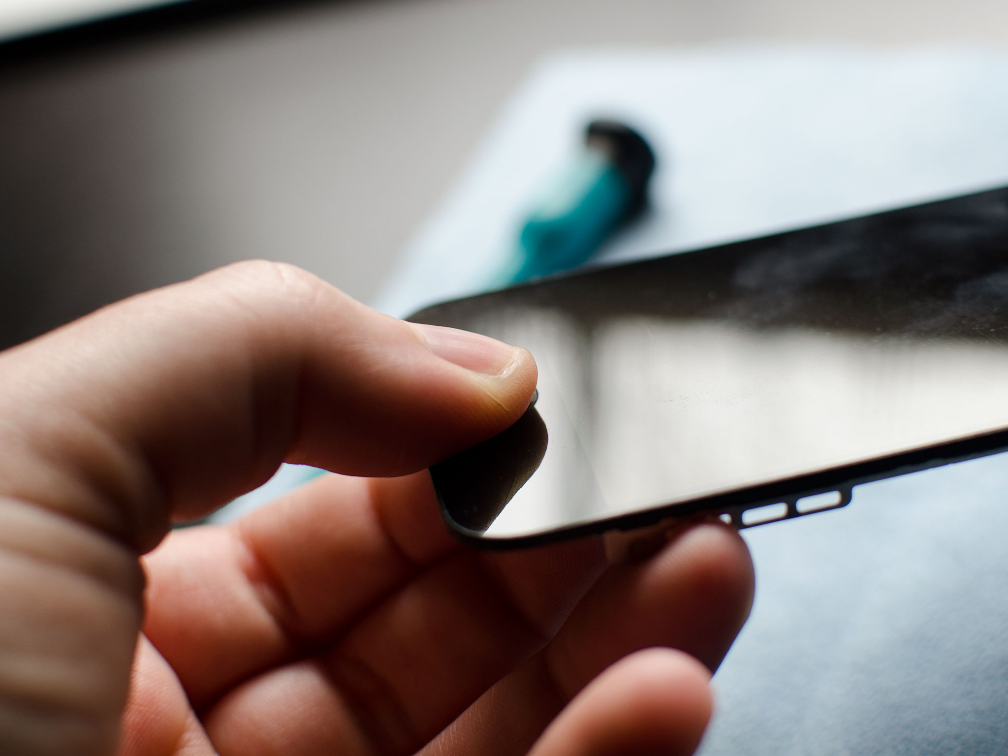

- Now place your suction cup above the Home button and gently pry up from the bottom. Take care not to pull the entire screen off as the top of the screen is still attached by several cables. You only want to release the bottom portion.

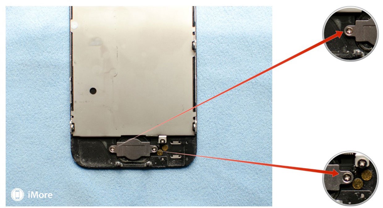

- Using your #000 Phillips screwdriver, remove the two screws that sit on either side of the Home button assembly.

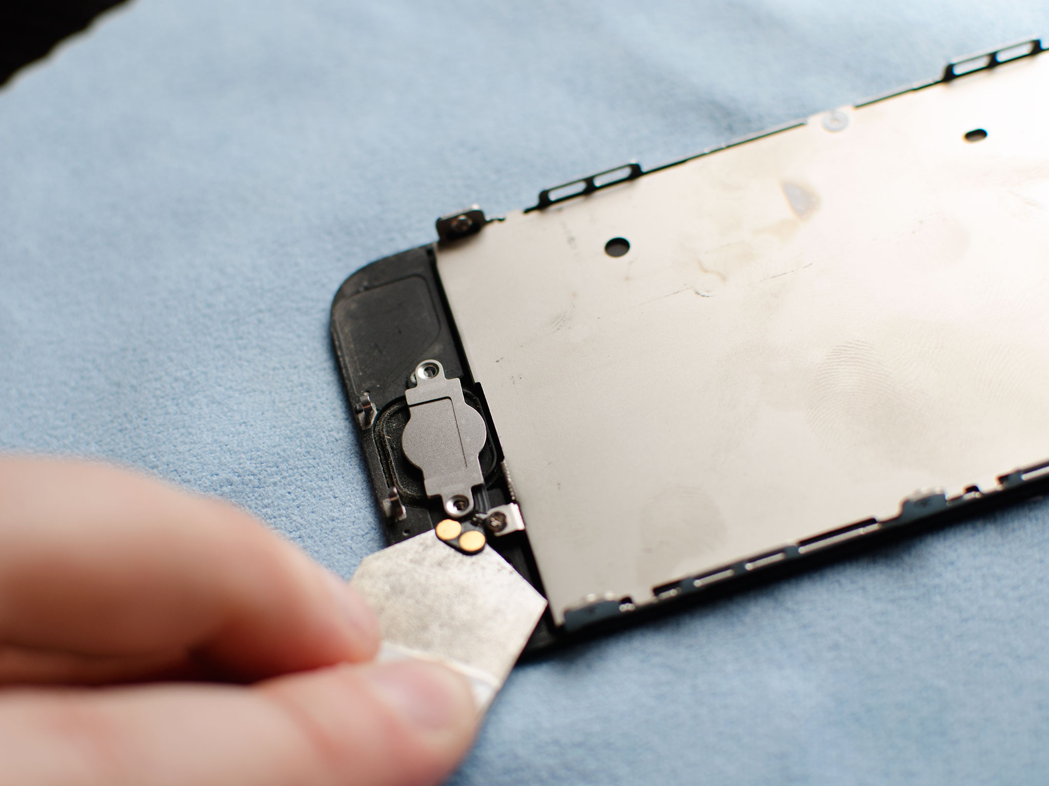

- Using either a razor blade or an iSesamo opening tool, work up the adhesive on the right side of the Home button cable.

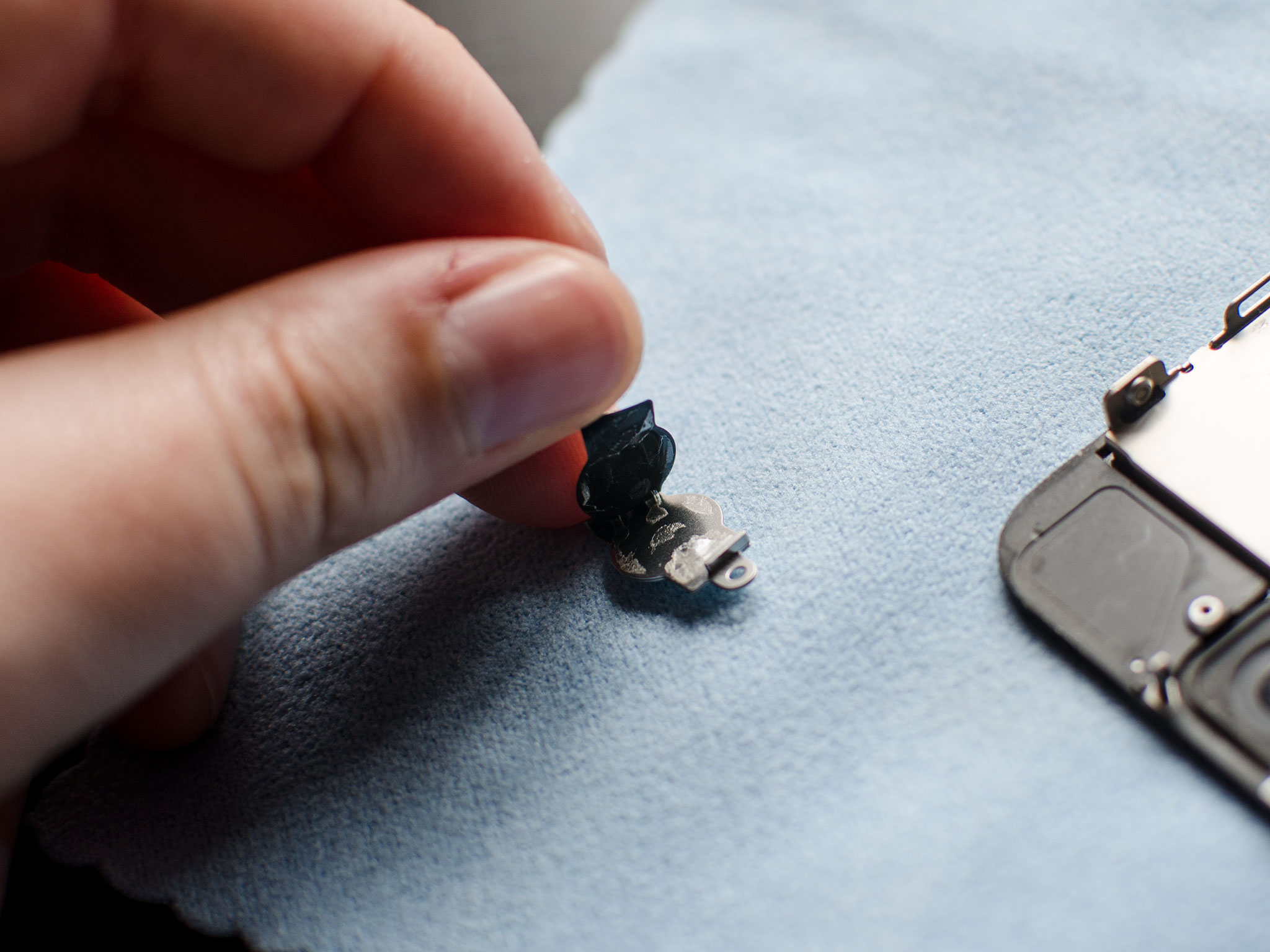

- The Home button cable and shield should now be free. Lift it off the display assembly gently.
- Again using a razor blade or an iSesamo opening tool, peel the actual Home button cable off the Home button shield. Take care to remember the orientation of the shield.

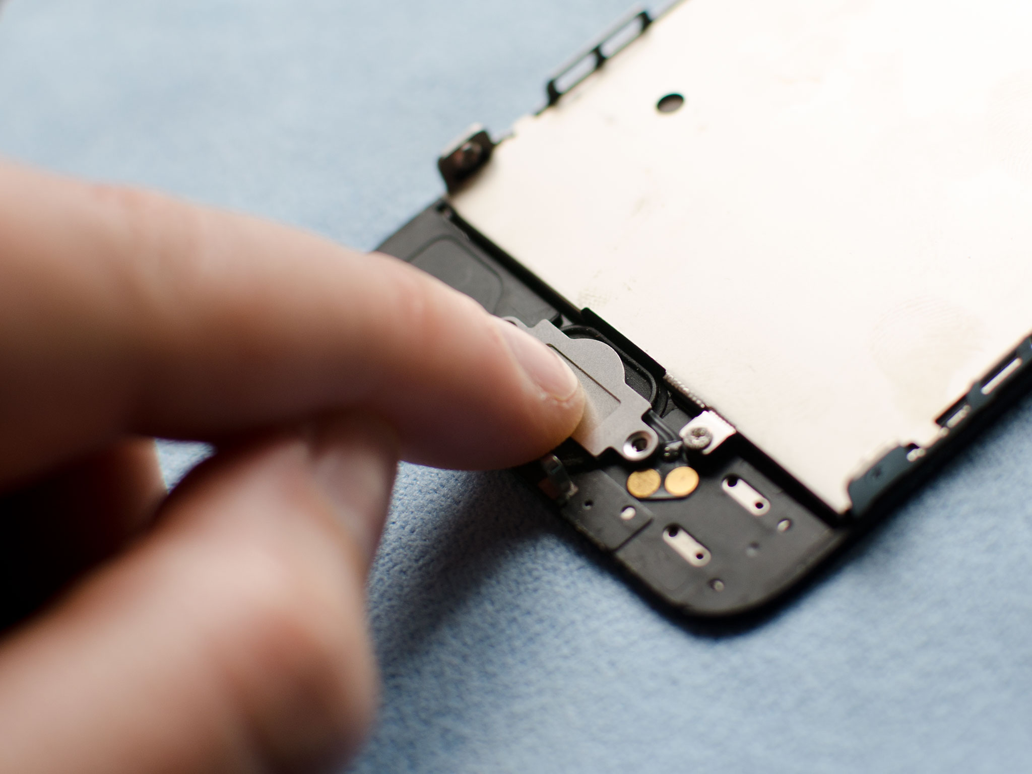

- Place the new Home button cable on the shield in place of the old one. Peel off any adhesive strips in order to expose the adhesive so it sticks to both the shield and the display assembly when replaced.
- Return the newly assembled Home button assembly to the back of the display assembly.
- Replace the two #000 screws on either side of the Home button assembly using your #000 screwdriver again. This time, be sure not to screw the two screws in too tight. If you do, it can prevent the Home button from depressing correctly. You want the screws to be firmly in place but not tight.
