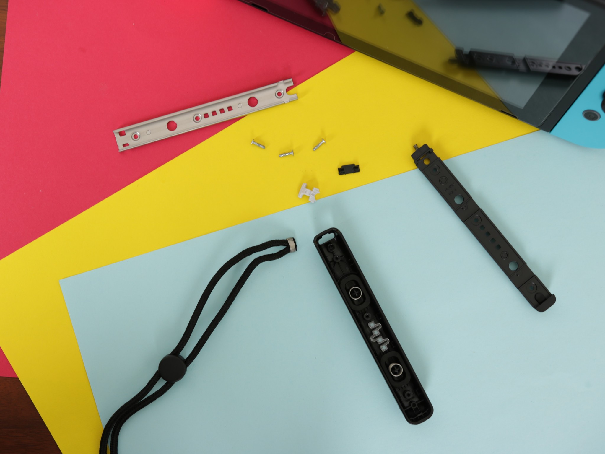

Step One: Remove the Metal Plate
With your handy screwdriver, remove the three screws on the metal plate. This will reveal a plastic insert underneath of the metal one.
There is a small piece of black plastic and a spring that is loosely held in place by that metal plate. DO NOT LOSE THIS This is essential to locking the bumper in place.
Step Two: Remove Plastic Insert
Carefully, remove the plastic insert by pulling up gently on the bottom and moving it to the left so that you can remove the locking bar with it. Make sure you remove this gently so you don't hurt the plastic or any mechanisms underneath this insert.
Step Three: Remove the Strap
Before you can remove the strap, you will have to remove the white locking mechanism on the outside of the bumper. After you do that, carefully remove the strap with your screwdriver and pull it out the end side.
Step Four: Put it all back together
Now that you have officially removed your strap, you have to put the bumper back together. Start by inserting the white locking mechanism into the plastic mechanism and pulling that through the designated hole on the base of the bumper.
After you complete that, put the small spring in the little area designed for it and place the little black plastic piece on top of it.
Finally, place the metal plate back on top and screw it in!
Four easy steps and you are officially strap-free!
