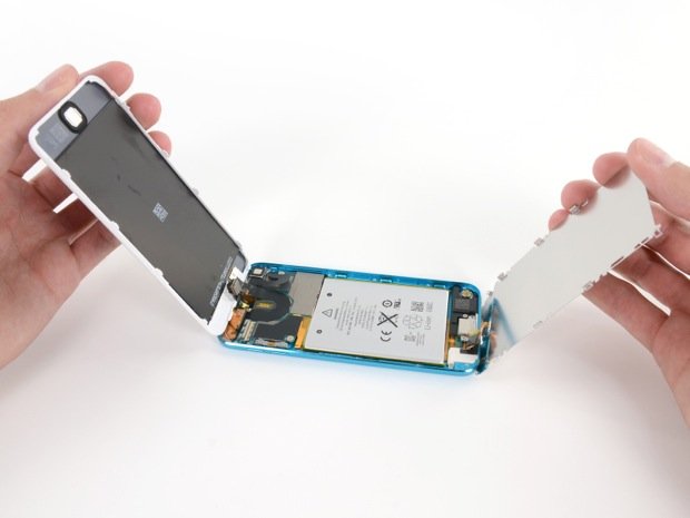

Apple's new iPod touch 5 is just starting to hit store shelves but it's already been torn down, and had all it's thinner, lighter parts examined. iFixIt did the tear down duty once again, and while the iPhone 5 was given a 7 out of 10 repairability score, Apple's newest generation iPod touch only achieved a 3 out of 10.
With no external screws, the Touch is tough to pry open, and its logic board utilizes two hard-to-manage ribbon cables: the battery, logic board, front camera, speaker, headphone jack, Lightning connector, and home button switch are all soldered onto one cable, while the volume buttons, power button, LED flash, and rear microphone are all attached to another cable. Repair is not impossible, but it's certainly going to be difficult and expensive if one component breaks. These factors combined earned the iPod a 3 out of 10 on our repairability scale (10 is easiest to repair).
In the past, the trend was typically that the thinner a device got, the harder it got to repair. The iPhone 5 proved that theory wrong and actually ends up being extremely easy to repair. We've already shown you how to replace a cracked screen on an iPhone 5 and we believe many users with moderate DIY skills will be able to do it on their own with no problems.
Since Apple has chosen to link many functions to single cables, it can make a hand slip or a torn cable a lot more expensive this time around. While previous generation iPhones and iPods have put functions like the proximity sensor and noise canceling mic on the same cable, they were relatively cheap and inexpensive. Components such as the dock connector, Home button, flash, and speaker had their own assemblies making repairs easier and more cost effective even if you did make a mistake.
This probably won't be the case with the fifth generation iPod touch. While we aren't sure what component cost will be for these guys yet, I'd be willing to bet it's going to be higher than components on previous models. While a repair isn't impossible, it'll definitely cost you more time and money than before.
