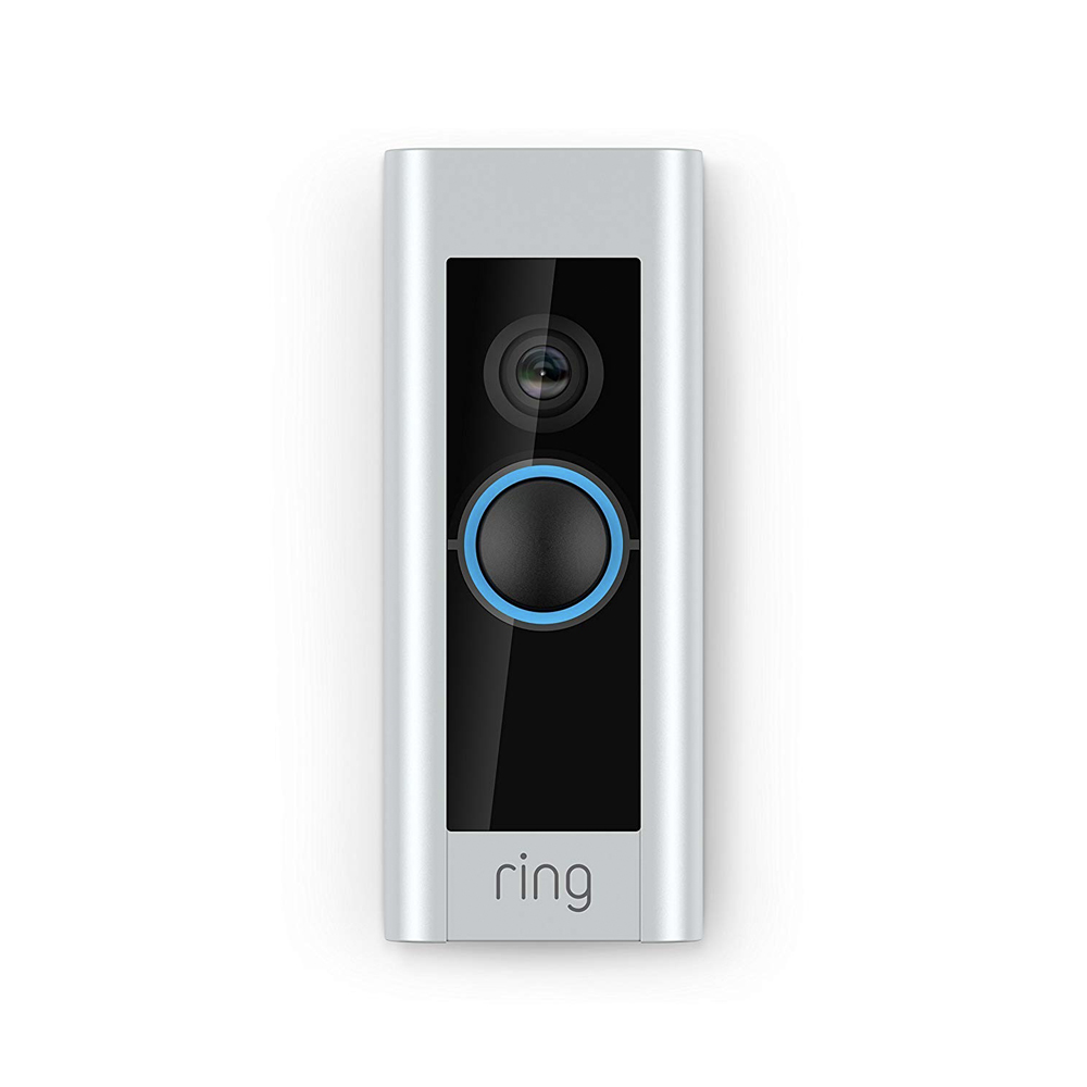

The Ring Video Doorbell Pro is the lowest price it's ever been on B&H right now at just $139, but what you may not have realized when you hit that "buy" button is that your existing doorbell chime may not be powerful enough to support the extra wattage needed for the Ring Video Doorbell Pro, which needs a more powerful 30VA transformer to work perfectly all the time.
Use your phone to view live video or use Alexa to communicate with whoever is there. Provides 1080p video with a 160-degree field of view. Uses integrated infrared LEDs for night vision. Includes motion detection and bank-grade encryption.
