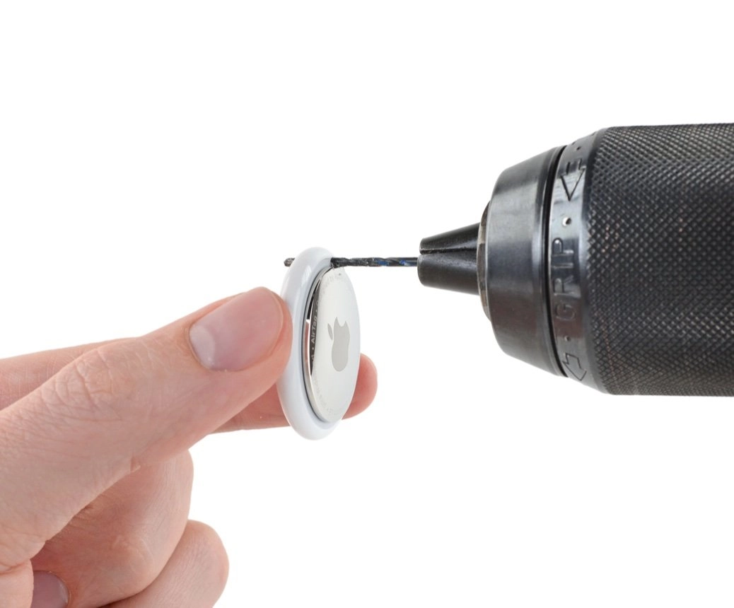

Cynicism aside, the lack of any kind of mounting hole is a potential issue for anyone not wanting to buy any airtag accessories. So what do you do about that? You make your own hole, of course.
After some reconnaissance inside our first AirTag, we grabbed a 1/16" drill bit and carefully punched a hole through the second tracker in our four-pack—after removing the battery, of course. We miraculously managed to avoid all chips, boards, and antennas, only drilling through plastic and glue. The best part? The AirTag survived the operation like a champ and works as if nothing happened.
I'm still not sure I'd recommend punching a hole in your $29 AirTag, but hey-ho. Check the full iFixit post for the lowdown.
