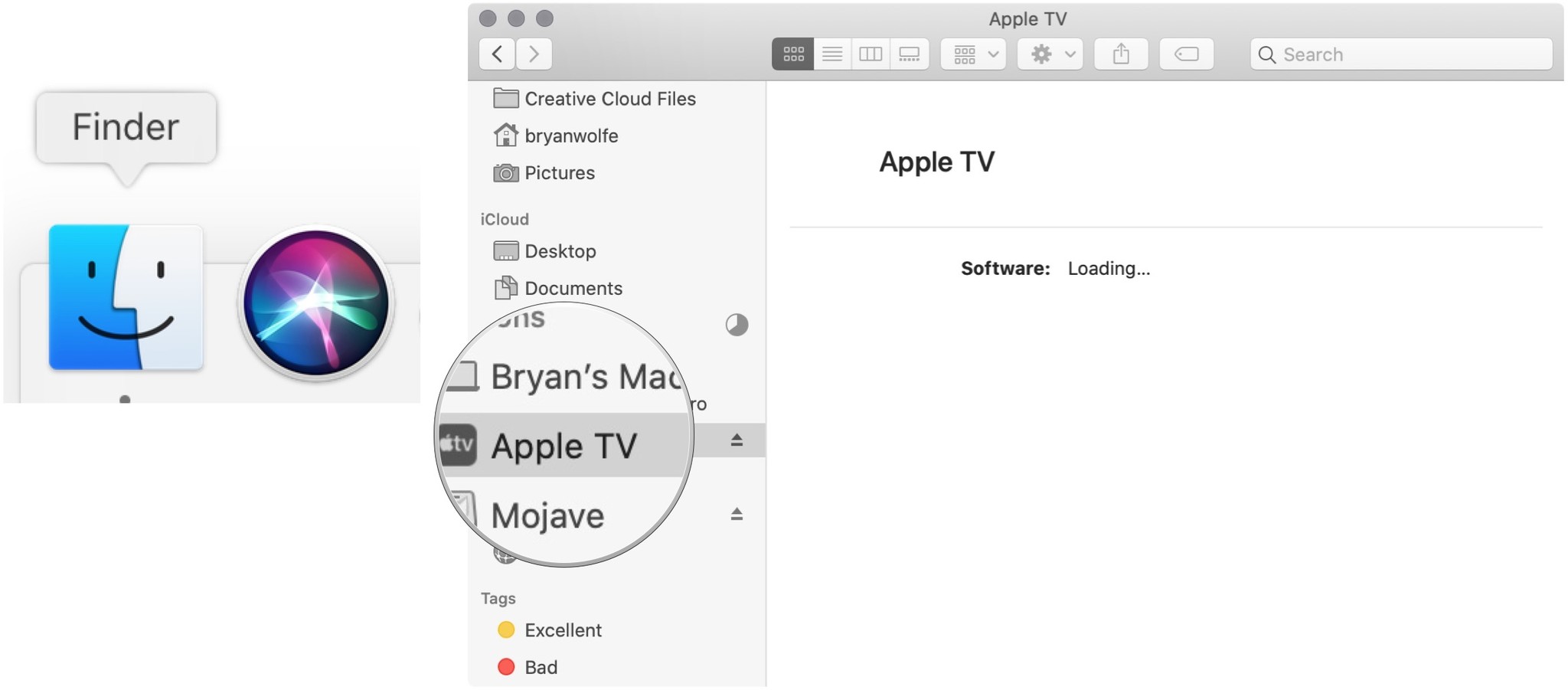

How to use macOS Catalina to downgrade your Apple TV HD
  1. Download the latest publicly available version of tvOS 13, saving the file to your Mac's desktop.
  2. Connect your Apple TV HD to your Mac using a USB-C cable.
  3. Launch Finder on your Mac.
  4. Select the Apple TV under Locations in Finder.
  5. Click Restore Apple TV while holding down the Option key.
  6. Select the tvOS file you downloaded.
To downgrade your Apple TV HD, download the latest version of tvOS 13, connect the Apple TV with your USB-C cable, launch Finder. Select Apple TV under Locations in Finder. Click Restore Apple TV while holding down the Option key. Select the tvOS file you downloaded
To downgrade your Apple TV HD, download the latest version of tvOS 13, connect the Apple TV with your USB-C cable, launch Finder. Select Apple TV under Locations in Finder. Click Restore Apple TV whil (Image credit: iMore)
From here, extraction and installation of the tvOS firmware begin. Once complete, you'll be asked to set up Apple TV on the device. Unplug the UBS-C cable when complete.
