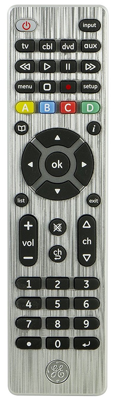

- A simple and inexpensive remote: GE 4-Device Universal Remote (From $8 at Amazon)

Simple, old-school remote to control your Apple TV
Although this is a very basic remote, it can still work with four devices at once. It also uses conventional AAA batteries (not included). You'll get months of battery life, and you don't have to worry about another charging cable or station in your home.
Just as a bonus, the GE 4-Device Universal Remote already comes pre-programmed for Samsung and Roku TVs.
