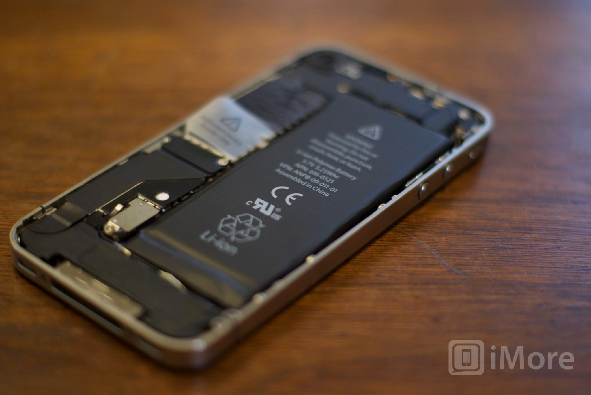

How to replace the battery in a GSM/AT&T iPhone 4
If you're iPhone 4 is going on a few years old and your battery just isn't what it was before, replacing the battery can make a huge difference and possibly prolong the life of your device another year if not longer.
Article continues belowAn iPhone 4 battery replacement is a super easy repair to perform and only takes about 10 minutes. It'll also cost you a lot less than shelling out money for a brand new phone, especially if you're out of warranty.
Symptoms of a dead or dying battery can include drastically reduced battery life, random reboots, and sluggishness even after a restore. In rare instances, a completely dead battery may result in an iPhone 4 only powering on when plugged into a charging source and when unplugged, the iPhone will turn off instantly.
