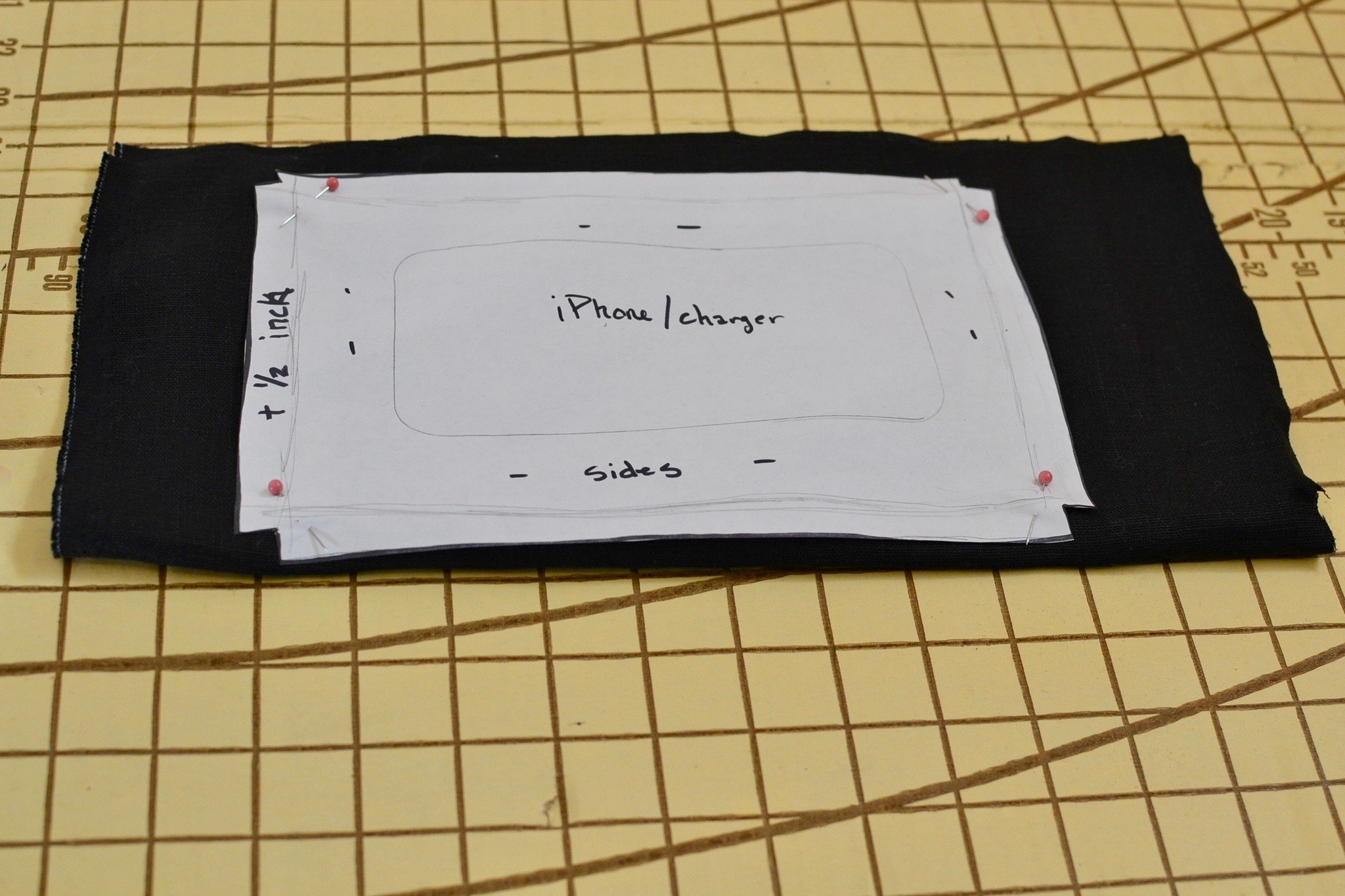

Make the pattern
To create this pattern, you'll need to do a lot of measuring. You'll need the wireless charger and your phone. Stack them on top of each other and set the stack on top of your paper.
Draw an outline around the largest device (your phone or charger, whichever is bigger). This is the starting point for finding the right measurements for the rest of the pocket.
Measure the stack height from the base to the top. This will determine how deep the pocket needs to be.
Add an additional half-inch all the way around the sides so you have plenty of room to properly hem it.
Cut out the pattern.
Fold your fabric in half, right sides facing out.
Pin the pattern to the fabric with the bottom of the pattern set up against the fold in the fabric. You're going to double the cutout to create the pocket.
