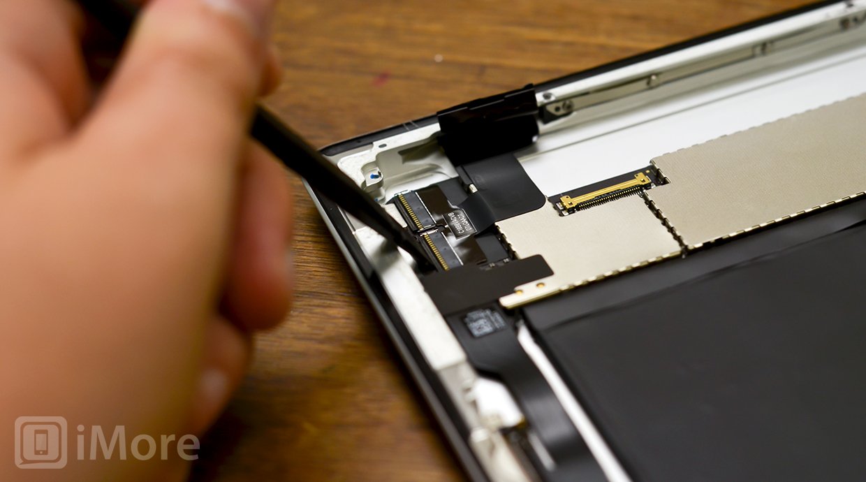

Remove what is left of the old digitizer cable
  1. Flip up the two clasps that hold the two sides of the cable in place.
Pry up iPad 2 digitizer cable
  1. Slowly back the end of the digitizer cable out of the socket and discard it.
Remove old iPad 2 digitizer cable
