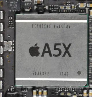

New iPad teardown shows A5X processor made by Samsung, increased die size for quad-core graphics
The fine folks at Chipworks have taken a closer look at the new iPad, particularly at the upgraded A5X processor. The die size was apparently increased by 35% to accommodate the quad-core graphics processing unit. They were also able to confirm that the new processor was made by Samsung using a 45 nanometer CMOS process. Chipworks also looked at the parts iFixit pulled out from their Austrlian iPad, and identified particular RAM, Wi-Fi, LTE, audio, and power management chips; much like the 5 megapixel camera unit, a lot of these were recycled from the iPhone 4S.
